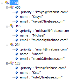

startAt + endAt uses .priority field to query the nodes, firstly I used to store the dateCreated to .priority... great then at code with just a .startAt, I grab the needed...
Later, a need occurred, to list the nodes also via another field, contacted firebase support the reply was :
so I started to make examples to understand how works, the need is to list [from - to] period + specific country :
conclusion store first the text field then the UTC, the previous queries saw us that can handle the alphanumeric using startAt and endAt!
