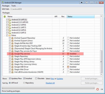

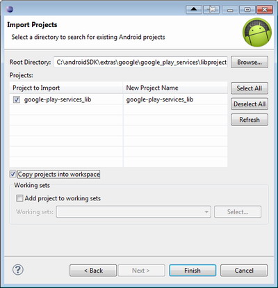

First, install ‘Google Play services’ through SDK Manager.exe is under Extras
This one will download a library project called google-play-services_lib exists at :
C:\you_androidSDK_path\extras\google\google_play_services\libproject
Go to eclipse and import this library project!
Warning you must check ‘Copy project into workspace’
otherwise will not work because the path is too long.

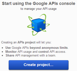

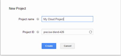

Sign in with your google account to https://cloud.google.com/console
And create a new Project, you will get a Project ID and a Project Number
We will use the Project Number later as sender-id..

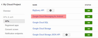

Enable the Google Cloud Messaging for Android (only this needed to be turned on) at API

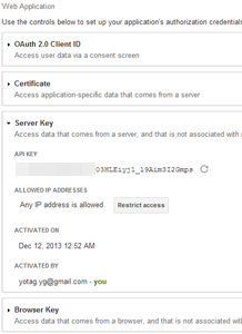

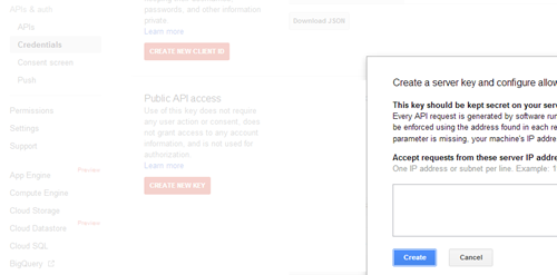

Google Developer Console change, there is a secret when creating ServerKey!
when you are here and Press 'Create New Key' 1st modal appears asking for which purpose when choosing Server 2nd modal appears asking to
write your server IP! dont do anything! just leave black the editbox and press Create!!!! live your myth with GOOGLE!

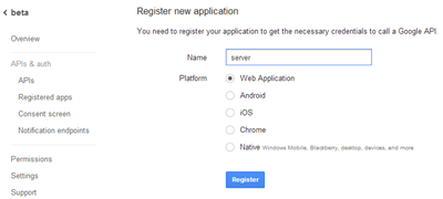

Goto Registered Apps and create a new one choosing platform Web Application. will we use later the Server Key - Api Key at PHP implementation
Goto Registered Apps and create a new one.

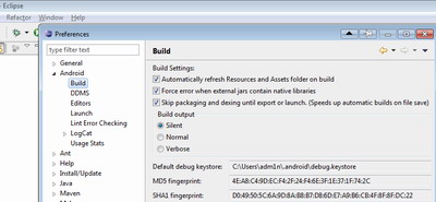

You can find the sign-key SHA1 at Eclipse > Window > Preferences (warning this is for debug only, you have to update it, when make the real build)
In general you reveal it also with a simple command line (when ask for password type android) :
keytool -exportcert -alias androiddebugkey -keystore C:\Users\you_user_name\.android\debug.keystore -list –v

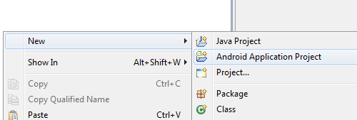

We create a test android project

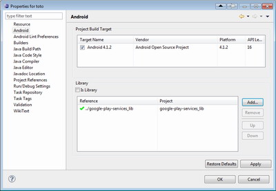

That makes a reference to library project called google-play-services_lib (that already imported into workspace)

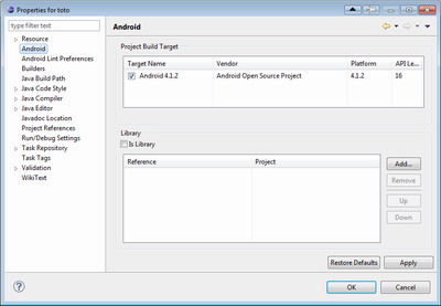

We select the new project > r-click > properties
Press ok, you will see the green tick.
So now the new project has dependencies right?

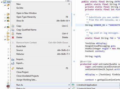

Then the other procedures, ok done, first run :
Oops I got :
wtf? google doesnt say anything about this!?
Go to manifest and paste this inside application tag!
Re-run! Works!

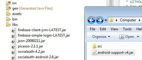

C:\androidSDK_path\extras\android\support\v4\android-support-v4.jar
Fire up SDK.exe and download :
Then drop it to folder libs
then I go to my application manifest and merge from (http://developer.android.com/google/gcm/client.html)

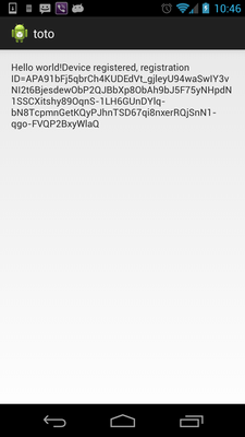

now, after you get a deviceID (aka use your mobile), create a sample PHP file using curl to post variables at google server, you first test!
workssss!

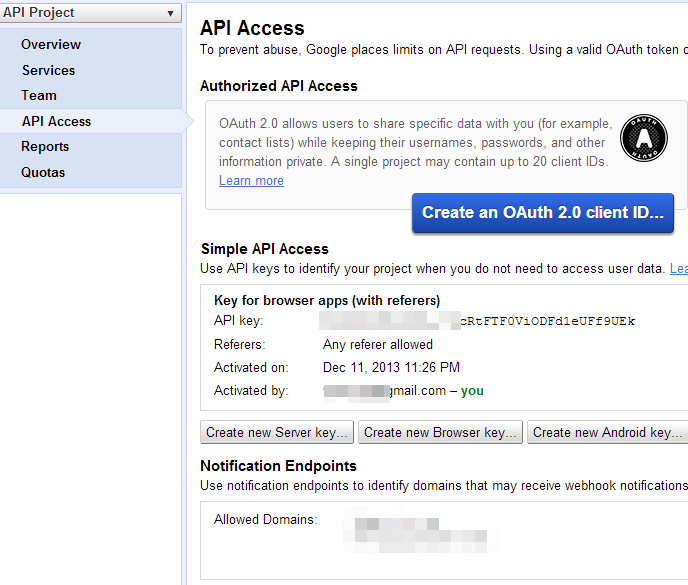

the only solution is to go at Google old console mode, by going to https://code.google.com/apis/console/b/0/?noredirect
or by clicking Go back
then there, click the Create new Project big button!
now the Project Number is in URL
then natigate to API Access to get the API key for PHP + manipulate Notification Endpoints

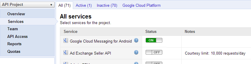

and dont forget to enable Google Cloud Messaging for Android under Services

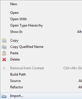

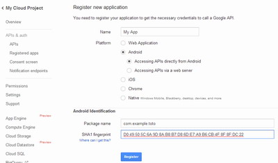

pause

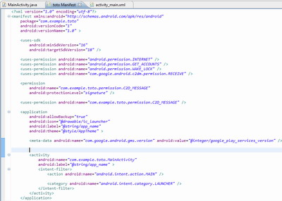

In next we have to set the proper permissions in manifest file :
As described at http://developer.android.com/google/gcm/client.html so I add these lines
<uses-permission android:name="android.permission.INTERNET" />
<uses-permission android:name="android.permission.GET_ACCOUNTS" />
<uses-permission android:name="android.permission.WAKE_LOCK" />
<uses-permission android:name="com.google.android.c2dm.permission.RECEIVE" />
<uses-permission android:name="com.example.toto.permission.C2D_MESSAGE" />

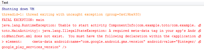

Oops I got :
<meta-data android:name="com.google.android.gms.version" android:value="@integer/google_play_services_version" />
Re-run! Works!

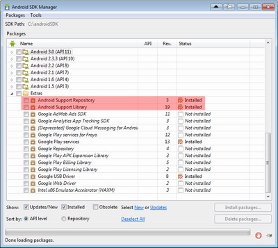

I copy the source to my application, but I got an error in imports about
android.support.v4.content.WakefulBroadcastReceiver
seems need

Error 401
I realize the server have to be on whitelist :
1-
https://www.google.com/webmasters/tools
2-
Google Cloud Console
API & Auth > Notification endpoints
references :
http://developer.android.com/google/gcm/http.html
http://stackoverflow.com/questions/11242743/gcm-with-php-google-cloud-messaging
http://distriqt.com/post/1223
http://www.robertprice.co.uk/robblog/2013/02/posting-json-to-a-web-service-with-php/
http://github.com/Redth/PushSharp
http://twisted.dyndns.tv:3194/DevForums/viewtopic.php?t=63#p181
Note: If your organization has a firewall that restricts the traffic to or from the Internet, you need to configure it to allow connectivity with GCM in order for your Android devices to receive messages. The ports to open are: 5228, 5229, and 5230. GCM typically only uses 5228, but it sometimes uses 5229 and 5230. GCM doesn't provide specific IPs, so you should allow your firewall to accept outgoing connections to all IP addresses contained in the IP blocks listed in Google's ASN of 15169.
**************************************** NOOOOOOOOOOOOOOOOOO
